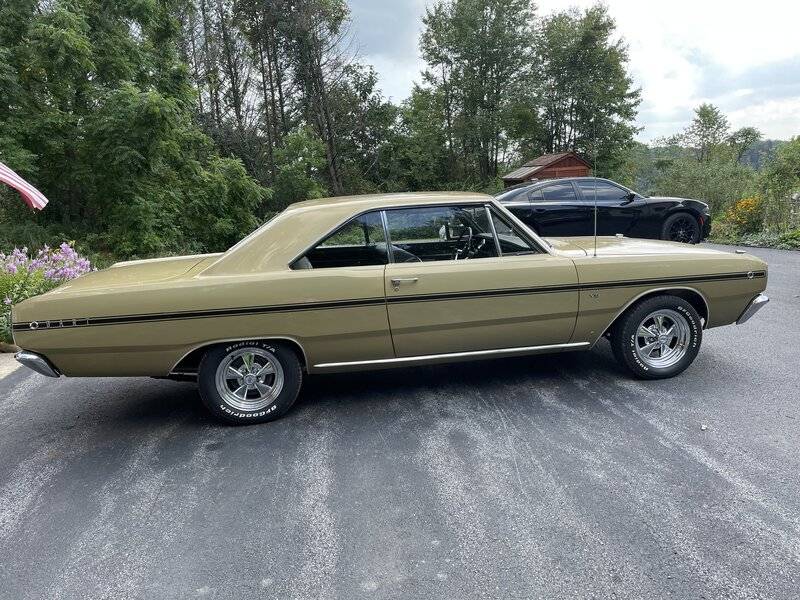

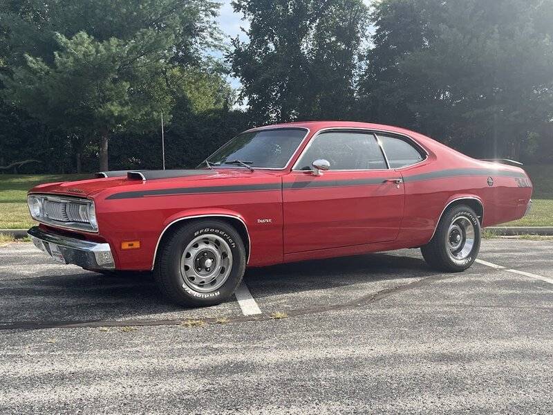

domdart FABO Gold Member FABO Gold Member Joined Feb 14, 2015 Messages 425 Reaction score 255 Location Johnstown, PA Sep 8, 2024 #2 Espo +1

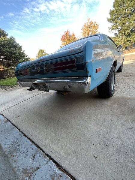

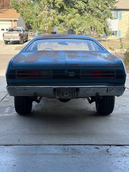

BrianT Here we go again... FABO Gold Member Joined Mar 13, 2007 Messages 6,189 Reaction score 3,261 Location Kansas City, Mo Sep 9, 2024 #3 These are ESPO +1 with 255's on 8 inch wheels. Springs are brand new in the pic and haven't been driven.
RGAZ Diehard Joined Jan 20, 2021 Messages 143 Reaction score 178 Location Greenwood, SC Sep 9, 2024 #4 @BrianT, What is your total ride height to the fender lip both front and back? I like the look. How much travel do you have on the front LCA? RGAZ
BrianT Here we go again... FABO Gold Member Joined Mar 13, 2007 Messages 6,189 Reaction score 3,261 Location Kansas City, Mo Tuesday at 5:18 AM #5 I'm at 28" in the back and 24 1/2" in the front.
