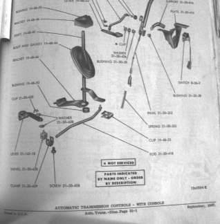

Now that I've figured out how to post pix, see if this helps. It's a 904 console shift behind a 340 in a 72 Demon.
From that photo angle it appears you are missing a short piece of linkage. The fiinal stick between the lever and the adjusting block. The 904 wont use all of it but it is long enough to acomodate the 727 too. I've had to make that piece.

Thank you RedFish for the pic. Still don't quite see the linkage piece you are referring to as missing. The Demon shifts fine on the jack stands......:scratch:...LOL
attachment.php
follow the line just above the 2 boxes with the printing in them. try flipping the rod and the square thingy upside down to help clear the plug.

Ok Maybe those are the correct pieces, just wrong arangement. Sorry about the cofusion. Happy moparing
