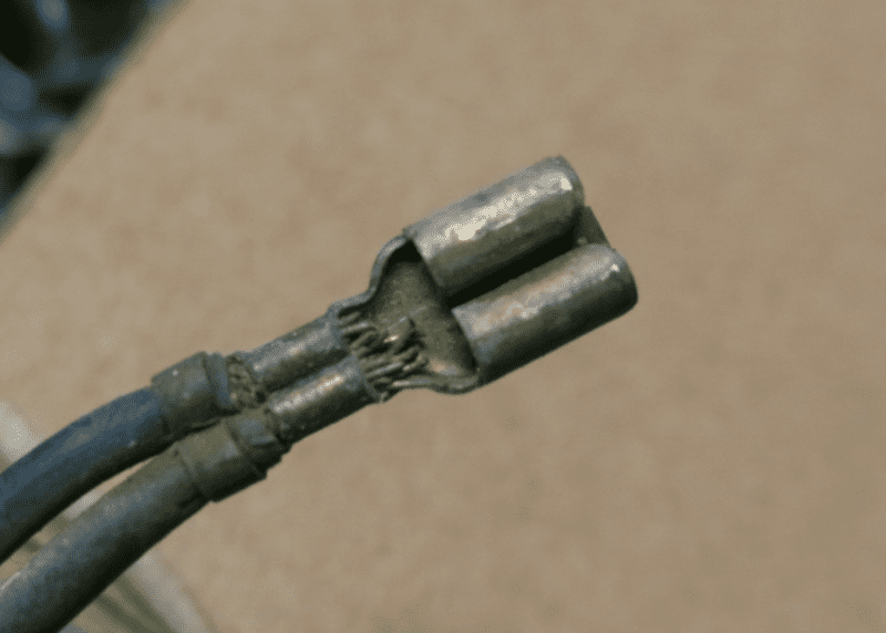

Also you mentioned pressing on the ballast resistor connection produced a change.
I'd pop the covers off of both connectors to look at the wire terminals.
Also you mentioned pressing onthe ballast resistor connection produced a change.
I'd pop the connector covers off on both to look at the wire terminals.
To remove the covers, depress the terminal's retaining barb. There's a little cutout in the plastic to slip a tool in.
Then the terminal can be slid out the back.
The conductors should be firmly held in the 1st crimp and the insulation held by the second crimp.
Other things that go wrong include the locking tab not locking to the connector and female terminal not gripping the male mating tab.

If you find a problem and it relates to how the ECU was wired in,
A clean method of connecting the ECU's power wire is to use a piggyback connector on the ballast resistor.
One spade gets the original terminal, the other gets the new terminal for the wire going to the ECU's top pin.
