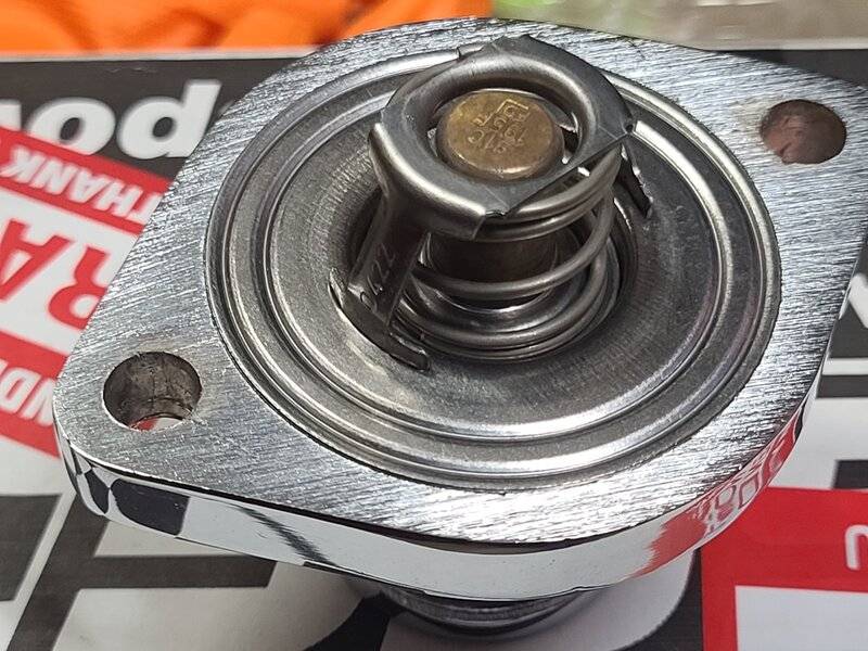

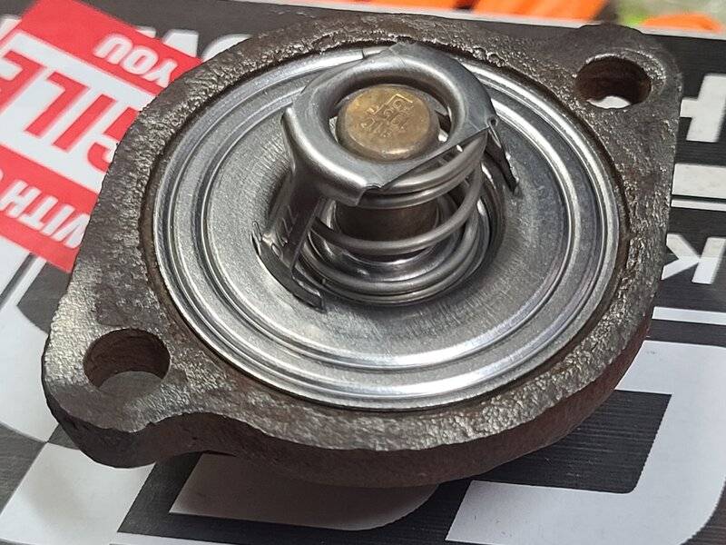

Got my new water neck and the thermostat does not fit, but fits perfectly fine in the old crusty water neck. I'm getting tired of new junk parts, now I need to grind the thermostat smaller to make it fit in the Taiwan/Chinese water neck.
I don't think I'd grind on the thermostat- those halves are crimped together around the outer edge and the last thing you'd want is a bunch of little parts swimming around in your radiator and water pump. Bite the bullet and get a different t-stat housing.
What intake are you runnng? Most aftermarket intakes have the recess the thermostat fits into.
This thermostat is not that type, taking a smidge off the edge will be fine. Also I may cut the recess a little bit bigger which is not a hard job to do, but it so sure does suck when I have to fix new parts.
Will the old one work? If so, I'd just use that one.
Maybe with lots of RTV lol. It's really bad, that why I'm replacing it.
Edelbrock 2176 Performer, there is no recess.
I'm not seeing the size difference in the original photos since the thermostat flange is obscuring the recess?
It's just about too small.

I really think QC has been getting worse over the past decade or two. There are things that I know some "mechanics" or "auto technicians" would not find until they have a big problem. That water neck would be a leaking because the gasket will not getting squished enough because the thermostat won't sit in the recess.

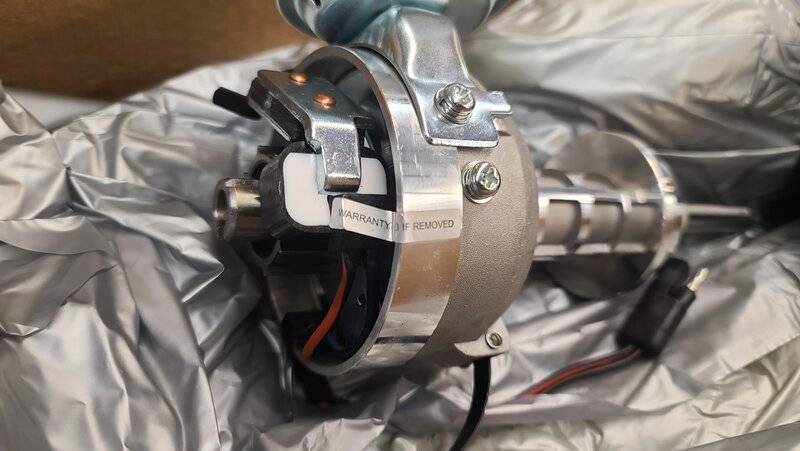

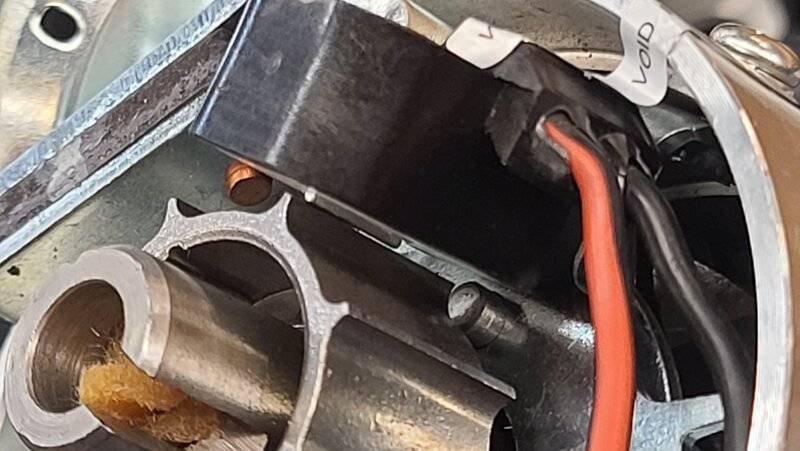

I have more QC gore, I bought a new "premium" distributor that needed a rebuild right out of the box. The reluctor was hitting the pickup, the mechanisms for the vacuum advance that pickup rotates on was bent and there was binding from the lack of proper lubrication. Oh wait, my favorite it the warranty void if removed sticker which will not only come off after some operation of the vacuum advance, but is also illegal for this purpose. QC is going away, and I know some of those **** mechanics will not catch the **** that I find.

Other than the smaller diameter recess, it's really not that bad, but I can fix the issue easily, someone else in this hobby without the same skill, knowledge and tools may not be able to. For that reason, I can't recommend that part.
