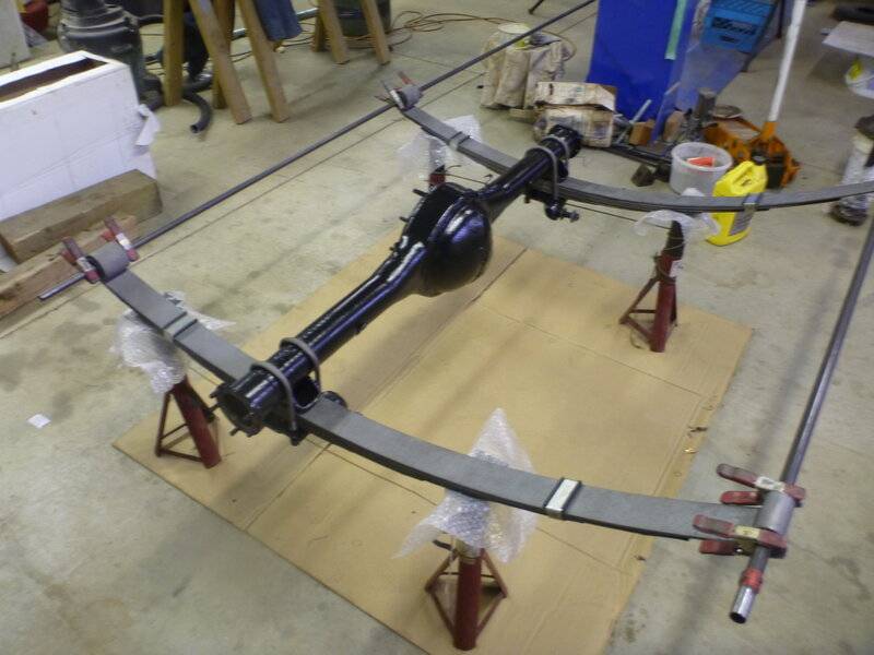

Semi Gloss Black. My Bee is in some expensive epoxy, but I cheated on my Dart and used a mix of Gloss and Flat Tremclad to get "semi-gloss".
Bee..
Dart...
