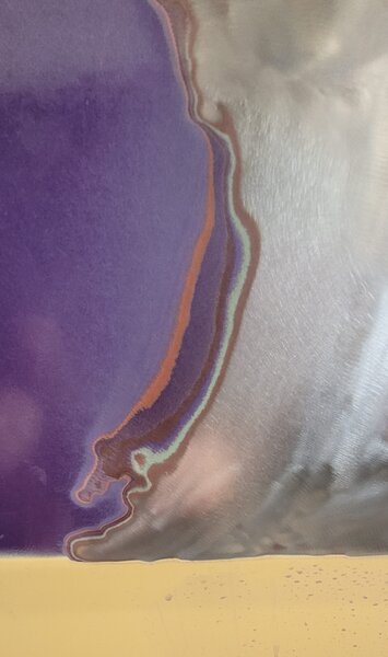

I've been taking my FC7 '70 Swinger down to bare metal for 3 months now due to it having multiple paint jobs. As you can see the first layer is definitely red oxide.
I never sand a car down to bare metal do to heat and not being able to see what was sanded or fixed before. I always used paint stripper and a razor scraper on exterior metal. Once down to the red oxide then put a coat of paint stripper on it and steel wool it the rest of the way.. Always tape the gaps so the paint stripper does not go into the jams unless your painting them. Then you only have to sand the edges. Using this method you can see all the original untouched metal. Yes the stripper removes body work too. I then use fine Crushed glass to do from the doors down and the front clip.
I used to use aircraft paint stripper a lot, until methylene chloride was banned by the EPA a few years ago. There was never a dusty mess with that! After that I could never find an acceptable stripper. What brand are you using? Thanks!
I found that crap stripper didn't work on factory paint. I really like the 3M Strip N Clean XT discs but its dusty. Some people like the 36 grit discs but they are brutal on metal.
[/URL]
I've been using a similar product on the Dart. It works great, but it sure sends purple dust everywhere. If it's warm enough outside I open the doors and turn on a big fan to blow the dust out as I'm stripping.
