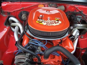

Here's a pic of mine. I found center of where the tubes would pass through the fenderwell and kept opening the holes untill the headers would pass through. Keeping the holes small as possible.
killer pic!!!! love the way you did that. insted of the big gapping hole a nice clean trimed out install !!! thanks!!
