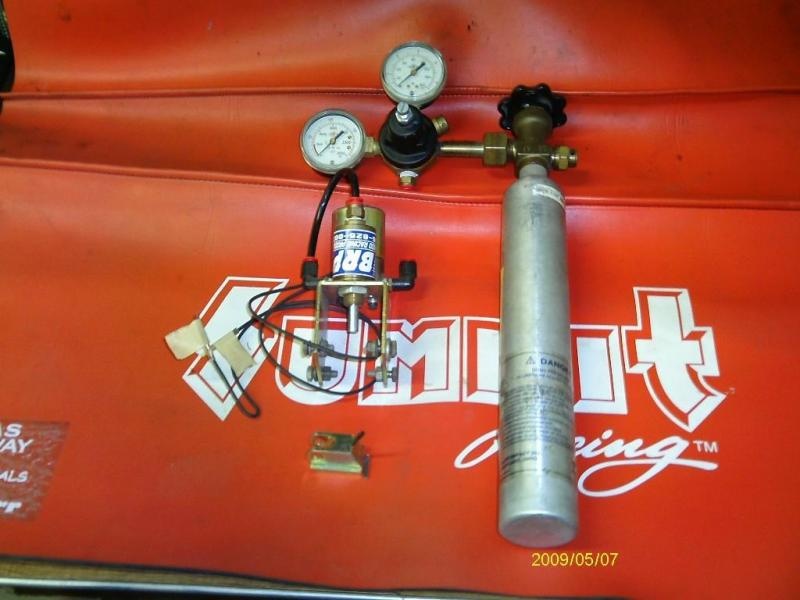

Good choice on the shifter, did you get the electric shift valve body? I have an air shifter for the turbo action shifter around here somewhere, may be a pic of it in my photos on here.
