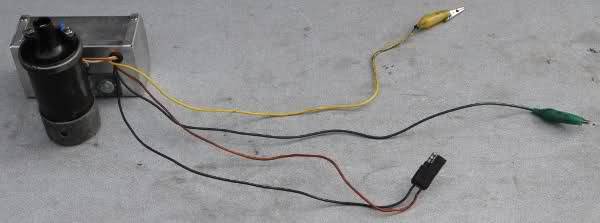

..............test fire this engine.........
............with this ignition system, a GM HEI triggered by Mopar breakerless distributor......
