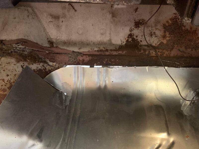

Okay in all fairness, I did manage to (yes even after measuring so many times) short the passenger pan, but the drivers went in perfectly. Guess its true, you do learn from your mistakes. And boy aint I making plenty.
Okay so after about a half day of trimming and fitting, I had two big pieces that fit my holes real well.

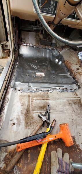

I did have to cut some extra off this passenger side, because it was already bad, so hell, why not. From there I was able to dab in some extra as I went around.
A little grinding later:
Then the drivers side:
After quite sometime later, I sat back marveling at the new floors. Not half bad! I mean, nothing to write home about of course, but like they say, "baby you shoulda seen what I started with." Dunno who says that actually, but I felt like it fit here.
WHEW
I am not a welder. I do not play a welder on TV. I never wanted to play a welder, and the most experience I have ever had was stick welding at the family farm on random things. This is definitely not that. It was at this point that my sun blind, welding weary, covered in flakes of metal and dirt *** decided to go home. Tomorrow we seam seal and get ready to paint the floors!

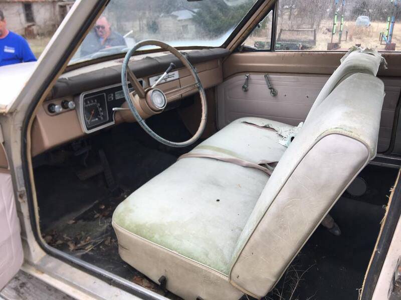

As you may or may not remember (it's been quite a bit since this Valiant effort began) the interior in my car as it was delivered to me, by me, was quite poor. The original interior was both ruptured and covered-ish in some crazy green colored cover. Said cover was dirty, and covered in poo de la Ratta, causing me to avoid it like the literal plague. Felt weird to the touch. Like a microfiber towel on a callused hand weird. Are you not familiar with that skin crawling sensation? No? If you rubbed a microfiber towel on my face, I would literally admit to killing President Kennedy decades before my birth to get you stop touching me with it.
*shiver*
Thank whatever you consider a higher power if you don't feel the same way i do about it, and let's revisit, shall we? I think we should.
Ooh no.
Oh that’s just nasty.
This backseat is does not look conducive to snuggling with the honeys. I mean, I don’t plan to honey snuggle in here, but I like to keep my honey snuggle options open. I'm kinda wise like that.

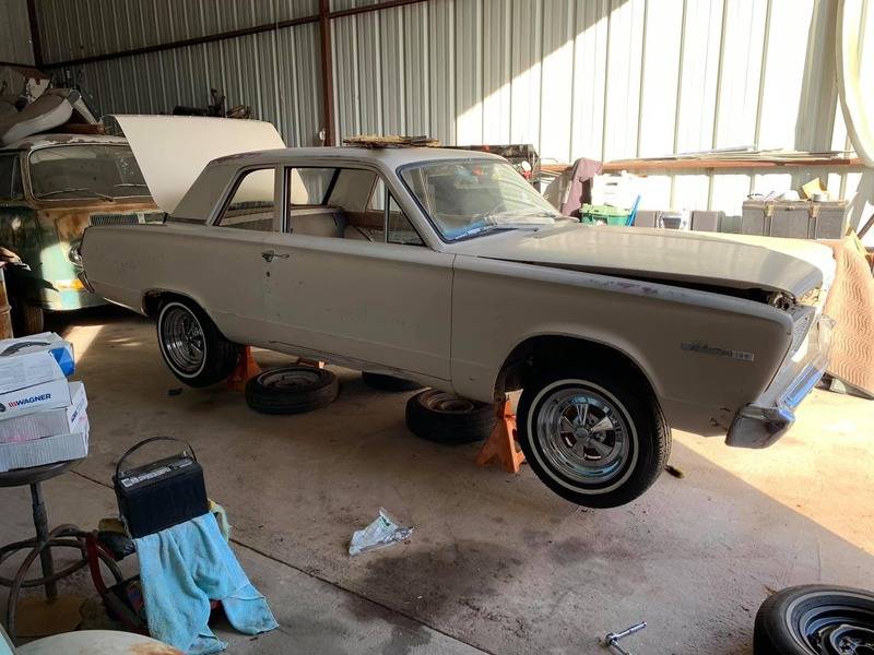

So as we all know, I bought a set of SBP Cragars a while back. They came with 215/70 and 205/70 tires. Tires are brand new, I'd love to use them if I could, but they seem to be a bit big. Anyone run this size? Rears fit fine, fronts seem to want to hit the upper fender, but I haven't had it on the ground yet to check. I was going to do that, but as you'll see shortly, I couldn't.
So, tire size recommendation? I may lower the front slightly, depending on how it sits once down on all four.
Second.
I fit the passenger side wheels fine. I do like this look. Ignore my messy shop. Its the sign of genius I have been told. I disagree, but who knows.

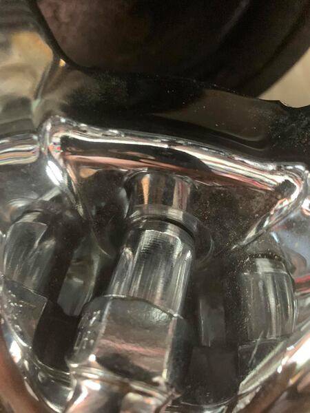

The problem is, the silly drivers side and its silly left hand lugs. So I had ordered left hand lugs for Cragar wheels quite a while back, but never fit them. Then, when i finally did go to fit them:
Yeah, thats a no from me dawg.
The shank is wayyy too large for these wheels. I called the guy i ordered the lugs from, and looked all over the world. He said something about certain Cragars from a certain manufacturer or time or something, they wouldn't work on. Woulda been nice for you to tell me that, (or list the shank size in your ad) yee ole wheel hardware saleman, but I guess that would be just too much work, eh? Regardless, apparently there are no left hand lugs for Cragar wheels that are this size. So now I guess I'll convert the LH lugs to RH. Shouldn't be hard, just one more thing to do I suppose. I should have, but never did, notice the difference between the two.
Looks like ill have a set of brand spanking new LH lugs and washers for sale if anyone needs them. Off to the corner of the Interwebz to order some RH studs and a different set of lug nuts.
