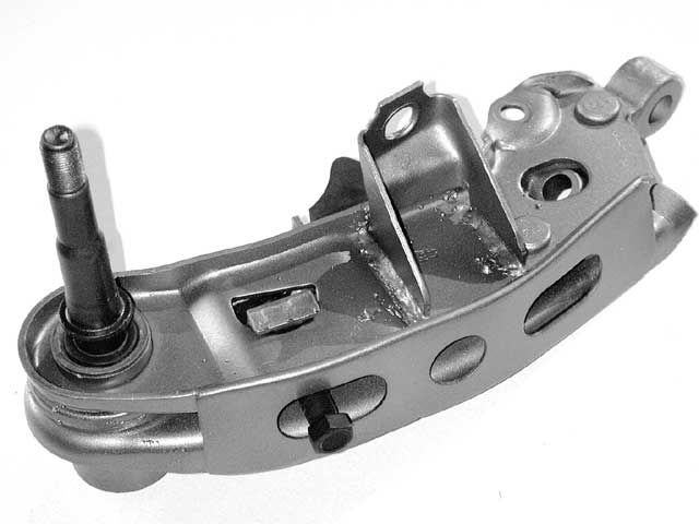

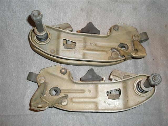

Yes, tabs can be welded on. There was a recent thread about it with pictures of tabed arms. I will see if I can find it and post you the link.
Be aware there are two different widths of sway bar. You need the sway bar before the tabs are welded on. The 73 and newer is nerrower than the 72 back.

This picture is 72 back.
attachment.php
This picture is 73 up.
attachment.php
There is also a thread where a member made a plate that went across the bottom of the lca with the tab on it but I can't find in now.
