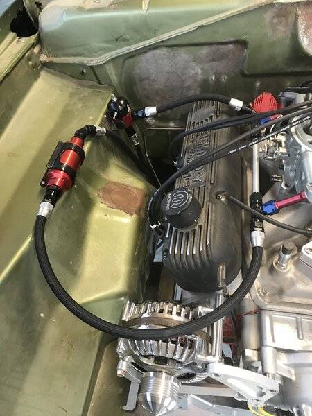

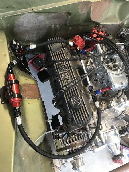

Good evening all. Plugging away on my duster and getting to the fuel line and Carb combo.
Using a Magna Fuel Quick Star 300 pump which comes with #10 fittings. Not sure if #10 is overkill for fuel line though. Motor is a 340 with 10:1 w2 with a strip Dominator, 8 inch converter with a brake and 456's. Some street some track. Motor was dynoed with an old 750 DP and a new QF750 because I ran the Holley prior build and my builder had the QF. Both pulled just about the same at 500 plus HP. What are your thoughts on fuel line size and Carb selection?? Thanks all and enjoy the holidays!!!
Got any pictures of this beast? We'd love to see it.

I've always wanted one of those chrome alt cases. Which one/brand is that?
I’m not sure what exact one it is. I bought it at a swap meet 10 years ago. It’s a chrome 60 amp externally regulated alternator. I would prefer a polished case over the chrome.
This is the closest one that would compare to it.
CHRYSLER Summit Racing SUM-812117 Summit Racing™ Alternators | Summit Racing
With that said, I will be swapping over to a Denso 60 amp internally regulated, but still a 3 wire. I do not like 1 wire alternators.
Never mind the pink, I get all my starters and alternators rebuilt from a local shop, and he always accents my stuff with pink as an inside joke, that never dies.
I tend to have an issue with sharing my wares on the Interweb, but here goes nothing. Its a work in progress that hopefully is getting a bump in the butt since i retired a month ago!! Honest critique is always appreciated as is advice from the experienced.

What Im leaning towards.
