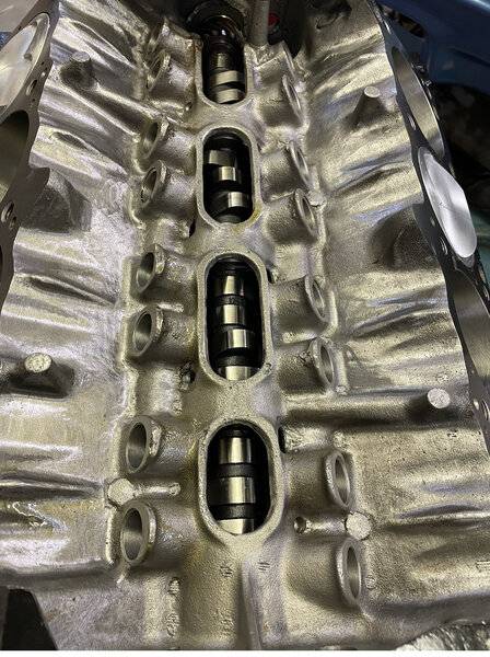

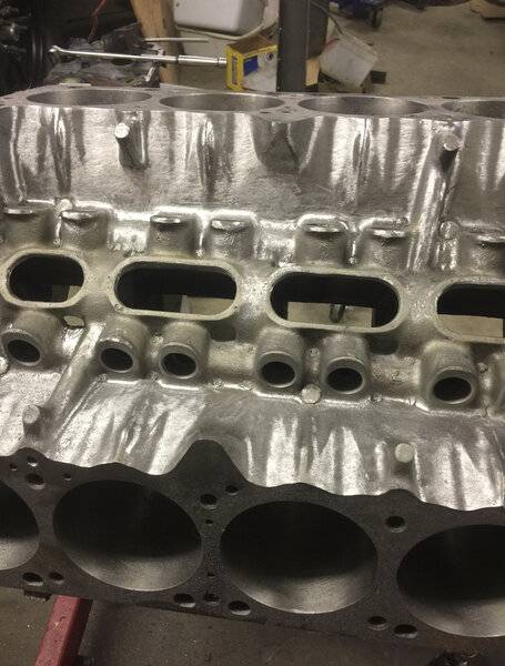

I’ve just heard of cases where it’s come off and gone into the oiling system. It’s more time consuming but I like to clean mine up with a bur.

Sometimes I put more effort into it than others. It’s always a good idea to open up the drainback holes and drill a couple extra.
