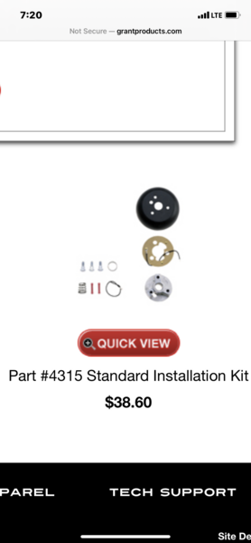

You might want to verify the installation kit part#. This is the one I’m using on my 67 as called for in Grants chart, which has the copper foil on the backside of the splined adapter that the horn roller contact rolls on.
Or are you using a different steering column?
Im using a Joe’s Racing steering wheel which I had to drill to fit the Grant #4315 but haven’t got around to getting the horn hooked up atm.
I may still have to get some fab work done on the column to switch adaptor - Trying to use a Toyota column adapted for the Grant wheel. Really outside the box stuff is what I am doing.
