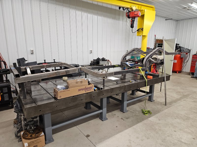

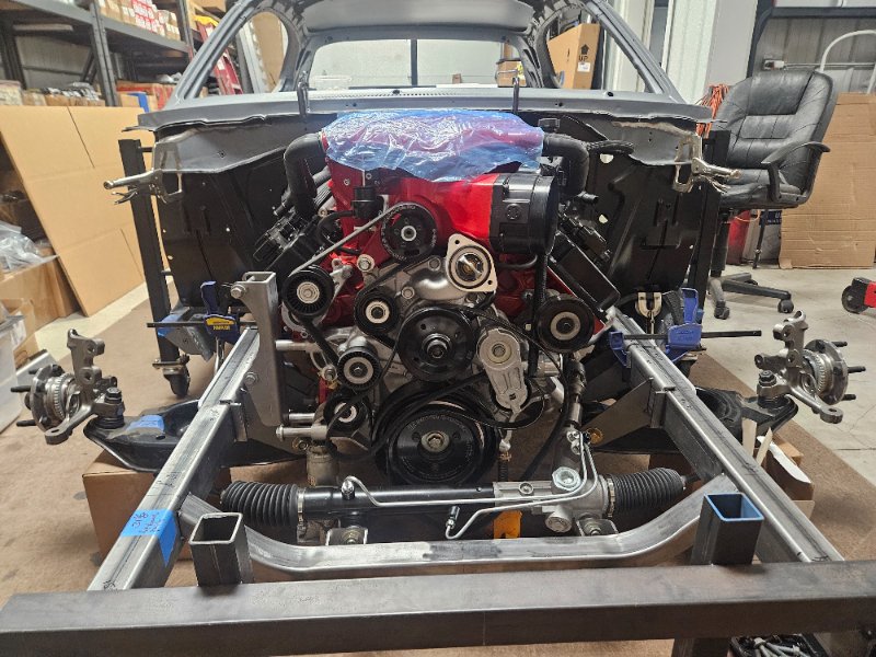

using factory rails makes it much easier to buy parts built for them, That is what we did. Also Using them will also take from the integrity of the unibody structure and a cage should be added
yes, that would tie everything together but I don't think the factory rails would go straight back to the frame mounted leaf spring box, I thought they had to be at a bit of an angle. but, yes, that is the general idea for using them...along with putting an A-body front suspension in a car that was not built that way. just my way of making an A-body wagon.
were torsion bars used or coil-overs put in? if the spacers lowered the k-frame, to I'm guessing where it would be with the factory rails, was there clearance problems? or was it before spacers were put in? Thanks for all the insight!
I bought it disassembled with t-bars. I reassembled it to check fitment. It was originally built in the 70's. It had no inner fenders or support. I welded in nose bars with the top of the frame rails measured to a stock a body. Then I found out the bell housing wouldn't slide into the tunnel. I had the spacers made to lower the installed height of the k to compensate.
