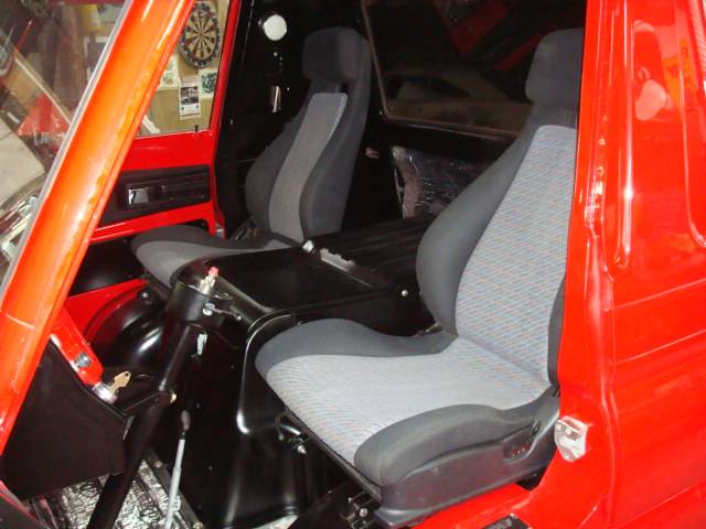

Currently have seats from a Toyota Cynos in my A100. I took out the Honda seats that it arrived with - at the time I couldn't get any original style seats.
Now I have the correct seats, and they will be fitted this year - after they are re-covered. :thumbsup:
The problem with side hugger seats in an A100, is that to close the doors, the seats have to be pushed back - or the sides clash with the armrest on the door.
