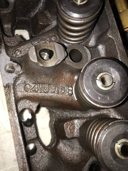

What numbers are they? Here's where the numbers are as an example.

Probably a bit of both. The 77 should be a open chambered head and the 89 should be closed chambered. Only the numbers will tell the story.
Ok, earlier I've been told the older holds up better. I'm not near the engines for about one month so pictures will have to wait. What does open / closed chambers mean?

Depending on the year/engine, open chamber heads are usually lower compression. The closed chamber are higher compression and more efficient. Here's some examples.
mopp_060800_hed_11_z+performance_mopar_cylinder_heads+452_open_style_combustion_chambers.jpg
late model heads with the heart shaped chamber take less timing which indicates more efficiency.
There are 4 versions with various casting numbers, 273 #315 closed heart shape, 318 open #675, 318 closed '67 only, 318 closed #302.
use them if cc match what you want to do
