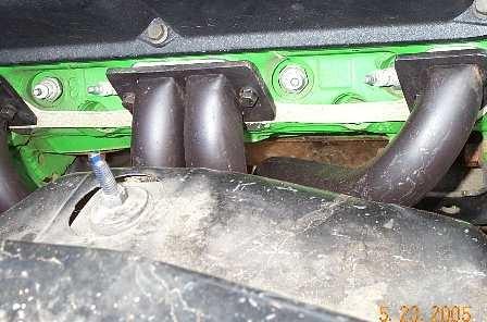

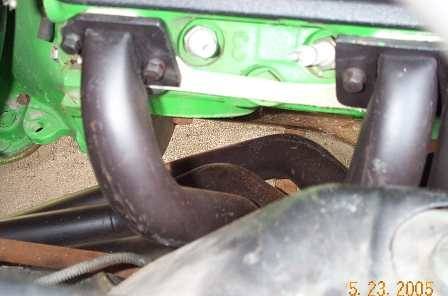

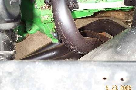

I guess I'll take some pictures of it tonight, and post them, because my Hedman Headers point TOWARDS that oil filter, not foward of it. All four tubes are running back that way and I dont see any way a 90 degree adapter is going to get a filter in there.
These headers are more like the TTI headers than anything else I've seen out there. If that helps any.
Ok Guys....here ya go....three photos of the area I'm talking about. I know, I know...the block shouldn't be GREEN....But it does look pretty cool that color!!!

where is the filter now? it looks like it might still fit with a 90* adaptor but you may need to turn it to an unatual position (which should be ok anyway)
Outlaw....that's why I'm asking....I am wanting to make sure it will fit there. The aftermarket 90 adapter is double the price of a remote dual oil filter setup. THat's why I"m asking, which do you think would be better.....?

I don't know what you use for a filter but there is three lengths of filters that have been spec's on these engines. The FRAM PH-16 or your favorite equivalent brand is the shortest and looks like it might fit.
I think I'd just put on the remote kit and get the extra oil capacity/filter capacity.
That looks REAL close....a lot closer than mine.
Well....I tried to put a filter under there....couldn't even work it under the header......but that was the regular sized filter....Have not tried a shorty one yet. BUT, I do like the idea of having the remote filters where I want them and the idea of having extra capacity. Now for that crazy question....Which one to buy....LOL.
