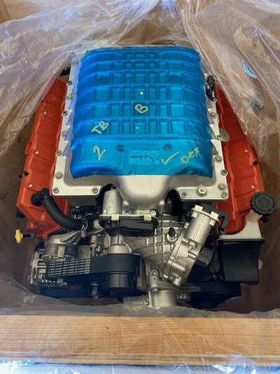

I bought a hellcat crate this week after several years of dreaming and saving! I'm in the planning stage and collecting parts to swap into my Demon. I will document as much as I can here. I've learned a lot from others' build threads - thank you
I've installed HDK, T56, subframe connectors, and a built 9" over the years, so luckily I have a good foundation to start with. The car currently has a reliably built LA 408 stroker with FI-tech fuel injection that I will probably post for sale here once complete or part out.
I'm mainly in collecting parts stage. The car currently has a LA small block and GM style T56. Does anyone know if bellhousings interchange LA to GenIII? ?

Small Block Bell housing pattern is 100% same as gen 3. Done it many times. :thumbsup:

Thank you 408 swinger. Saves me $900. Next up for me is deciding on flywheel, clutch and headers. I plan to mock up motor/trans on the ground first

Update - Pulled old motor, ordered a bunch of parts. Installed Schwartz Intercooler manifold. Stefs oil pan and TTI headers both back ordered. Keeping me from test fitting motor
I want to clean up firewall. Hoping to keep factory air set up, but not sure if lines will conflict where they exit firewall
Also trying to decide if it is worth it to mini tub. I plan to relocate the fuel tank for exhaust clearance. Trunk is pristine in this car. Hate to cut it, but at this point there’s no going back stock

Got the Stefs oil pan. Loooong wait, but I think it was worth it. Nice quality. Swapping to mid sump requires changing the pick up as most of you know. I used new main cap bolts as a precaution. Although after researching I think old ones can be reused. They are torque+angle, not torque to yield. Hellcat bolts are a different part number than 5.7 and 6.4.
Subscribed. I vote yes for mini tubs, you're going to be roasting tires with ease when the 6.2 is running.
I used the truck dipstick. Installed direct to block after removing plug. Reused the factory windage tray/gasket since motor is new. Also installed mopar 90 filter adapter for kframe clearance
Engine is in the car! Fits surprisingly well even though it looked massive on the stand. No cutting required except the typical frame notch for alternator. Everything on firewall had to go. Master cylinder has to shift
