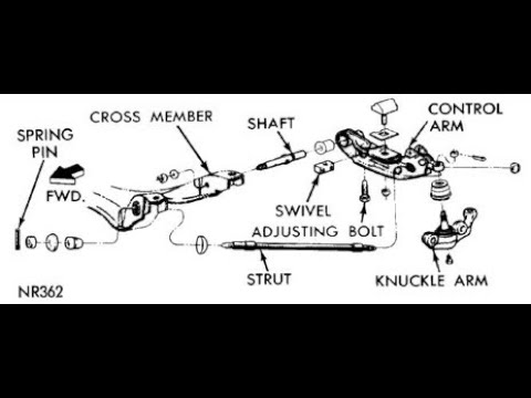

I'm starting to rebuild the right side upper & lower ball joint's on the Duster that I crashed several months ago. I have a question about the lower knuckle arm with the built in ball joint.(It has the big brads that hold the ball joint arm to the lower control arm.) Do I grind down the brads on one side,push them out and replace with grade 5 or 8 bolts???.. I think this is how I did it years ago on the driver's side when I replaced the ball joint's. I have got the right fender , fender well,core support all removed and ready to put her back together with parts from a complete 73' Duster that I bought for$500.00 bucks.Any advice would be greatly appreciated.Hope everyone has a wonderful Christmas and new year.
If you are talking about the lower control arm, the part that you are referring to is part of the control arm not the ball joint. See pics.
There are no "built in" ball joints, and no grinding needed.

The lower ball joint is part of the steering arm and replaced as a unit. The ball joint stud is what connects it to the lower control arm. The two mounting bolts that go through the lower ball joint/steering arm attach it to the spindle. You need to remove the rotor to get to the other side of those bolts to remove them. Looks like you need a new strut rod too. Hopefully you have all the parts you need off your donor car.
Thank you sir, You are correct on that.I made a mistake about this.I was looking at it when it was still all together, after I got it apart just a bit ago I seen it. Sorry about that.
Yes Sir, I was looking at it when it was still all together and once I got it taken apart a little while ago I see that the knuckle is the only thing that has the big brads.My mistake, Thank you for your input.I appreciate it.
