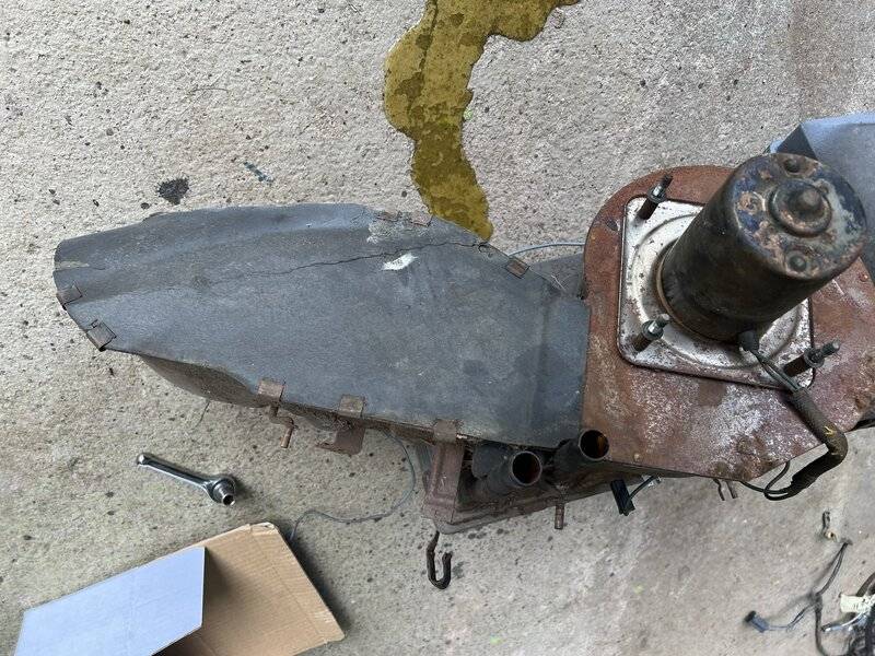

Just as the title says...
Just trying to confirm this blower is actually from a 68 Barracuda....
This is what the fellow who owns it this says...
The motor looks like Mopar but the bracket looks funky. A/C car may be?
According to the other photos, it looks like a heater hose tube goes through th hole and the other is held in place with the little bracket/tab.
There should be some numbers stamped I to the side of the motor.
May be able to help id the blower motor.
Chrysler did not stamp the parts catalog number on blower motors. The first two digits stamped on the motor (35) tell us it's not from 1968. No numbers started with (35) in 1968,including cast, stamped or parts catalog part numbers.
The date code 1315 Translates to May 1975.
The bracket may have changed over the years but the bare motor interchanges from the mid 60's into the 70's.
So the motor appears to be from 1975.
Now on to the next challenge...
What does the mounting bracket belong to....
The bracket for 1972 and older models used a different design from the one in your photo. Don't know the exact year of yours but it had to be from 1973 thru 1976
