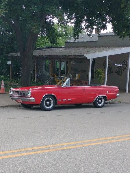

This all depends on whether you like a tall sidewall or not. I like the older school tall tire, and I have 5.5” wide steel rims, same width as a small bolt Rallye. If you go with a 60 series sidewall, you can run a slightly wider tire like a 235, but if you like a taller tire, 225 is the wax I’m width you should run on a 5.5” wide rim. This is my car with 225/70/14” on a 5.5” small bolt pattern wheel. I think it’s perfect for my liking
That's pretty tall for the front. How's it fit? Any rubbing? Looks really nice, btw.
Went with P205/65 R15 on 15 X 6 rims on all four corners. Tires are Falken pro touring, middle of the road price.

Nice looking Dart. Do you run this size on all 4 corners? What size wheels are you running?
