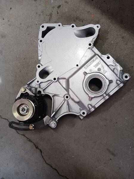

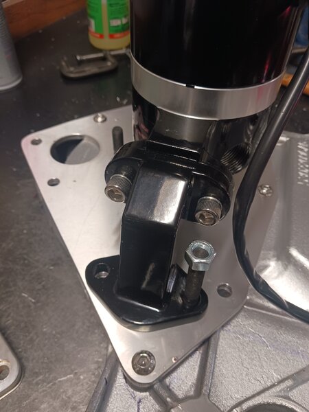

So…this is what I’m doing. Yes, to clean up the front of the ugliest engine on the planet…lol. I too have manual steering.
My friend trimmed the front cover and made a plate to mount a big block Chevy electric water pump. Along the way, I figured out how to use my mini alternator without much fuss.
I will be a one belt man: crank to alternator.
