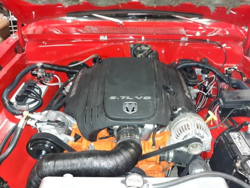

Ahh like this?

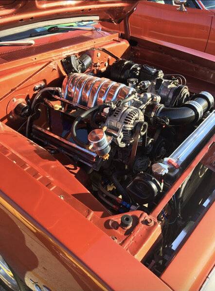

Did anyone need to cut any of the steering column that comes through firewall to make hemi fit. Seen someone who trimmed a bunch off their's . Its 70 dart. Just curious thanks
I relocated mine a couple of inches over away from motor just to give myself some space. It is very tight if you don’t. Since I was fabricating my own dash it was not an issue. I went with flaming river column as I also converted to coil overs with rack and pinion. Not the best picture but yes I relocated mine a bit. With regard to length I am not sure as I did not use OEM. I had to use two knuckles to get it lined up, and still not entirely satisfied with it. It is on my list for winter.
I relocated mine a couple of inches over away from motor just to give myself some space. It is very tight if you don’t. Since I was fabricating my own dash it was not an issue. I went with flaming river column as I also converted to coil overs with rack and pinion. Not the best picture but yes I relocated mine a bit. With regard to length I am not sure as I did not use OEM. I had to use two knuckles to get it lined up, and still not entirely satisfied with it. It is on my list for winter.View attachment 1715767553
So is it a must trim..or no..
