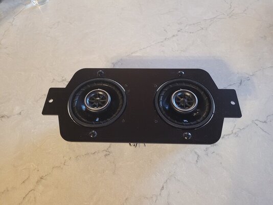

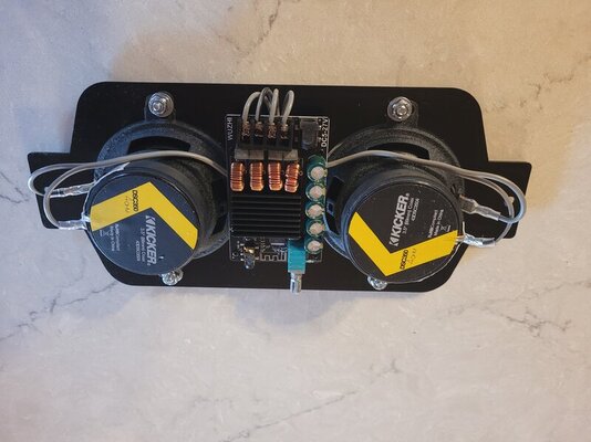

I’ve got a very original ‘65 Dart with heater and radio deletes. I needed tunes but I wasn’t about to cut up the unmolested dash. I got a speaker bracket from ‘74 Sport, mounted two Kicker 3.5” speakers and a cheap Bluetooth amplifier off Amazon (search DAMGOO TPA3116) . The amp fit nicely between the two speakers on the bracket. ‘74 Sport’s bracket is nicely made and fit perfectly under the dash.
My local hardware store had a bin of small carriage bolts. I forget the exact size but the smallest size they had fit the dash cut outs perfectly.
My car didn’t have wiring or a fuse for a radio circuit. It did have the top clip in the radio fuse spot. I was able to source a set of fuse clips from eBay (seller fmmpar) to add a fuse to power the radio in the factory fuse location.
There are a couple quirks:
1. The amp plays the AOL instant messenger start up sound when it powers on and the new message chime when it gets a bluetooth connection from my phone. Originally, I was thinking about trying to dump the chineesium firmware from the JTAG test points and hacking it to disable those sounds but as a kid who went to college when AIM was first getting popular it’s kind of grown on me.
2. The master volume is set by a knob on the board. Unfortunately, to adjust the max volume, I need to crawl under the dash which is a pain. I have the master/max volume set about mid way which is loud enough that I can run down the highway singing along to Lady Gaga on Pandora at the top of my lungs. It pulls about an amp cranked all the way up on a bass’y song (according to my Fluke amp clamp). I control the volume using buttons on the side of the phone. I keep my phone next to my leg and just reach down and toggle the phone volume buttons without taking my eyes off the road.
