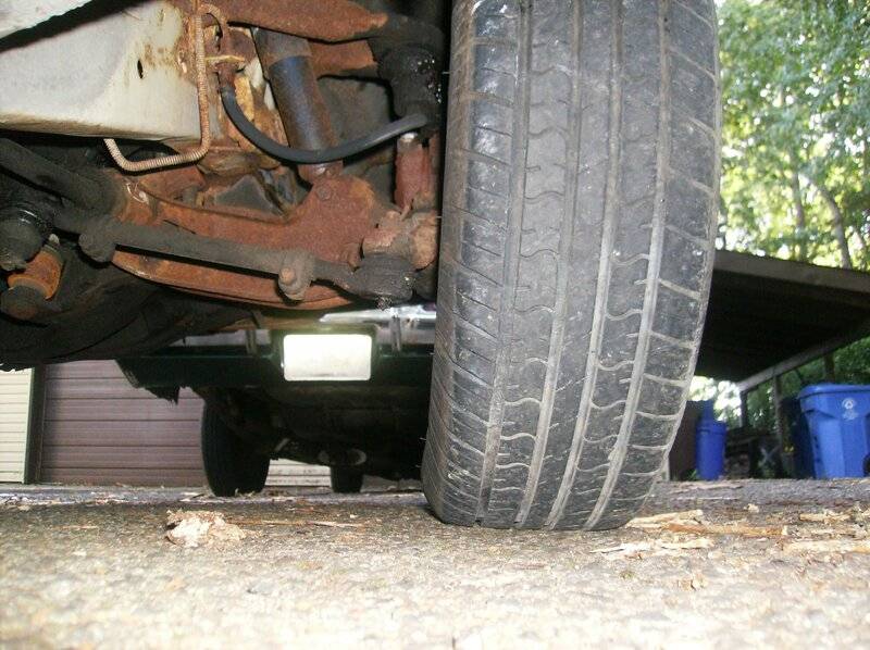

I hit a curb in the dart last night , in the rain . Spun out 180+ degrees , hit a curb . Not real hard , but definitely not soft . The rear passenger wheel took most of the impact , but the front hit as well . In the rear , it bent the rim . In the front , the wheel is pushed inward slightly , but where the steering wheel was normally centered is quite a bit off now . What should i check front and rear , and how do i check those for damage , bends , relocation etc. ? i am working in the driveway , shadetree style . 73 dart , stock slant 6 . I might be way in over my head here .
rear passenger side first - just missed the wheel cover
front passenger side - below -
Get some straight wheels on it and find an alignment shop that is familiar with Mopars to check and align the front end.

This is what I see according to the pictures:
The rear tire looks like the whole carcass shifted. It is junk.
The front has excessive positive camber. Lower ball joint shafts will bend if the impact is great enough. Sometimes it is the tie rod ends or sleeves that get bent. I've had upper ball joints bend but the lowers bend first.
