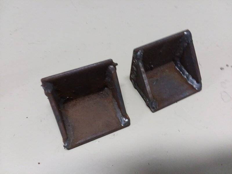

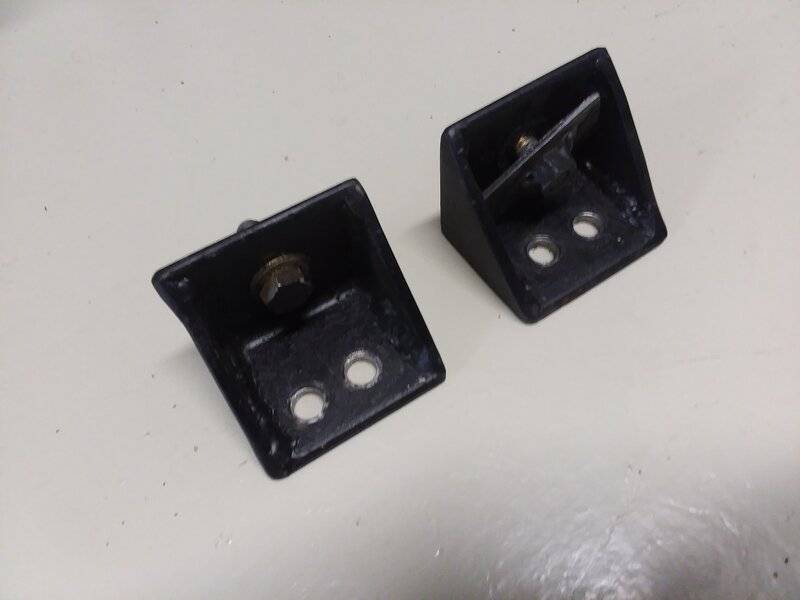

If you want to loose the shackles you can make up a pair of these lift brackets that go between the factory rear leaf spring mount and the unitized body sub frame bolt in area.

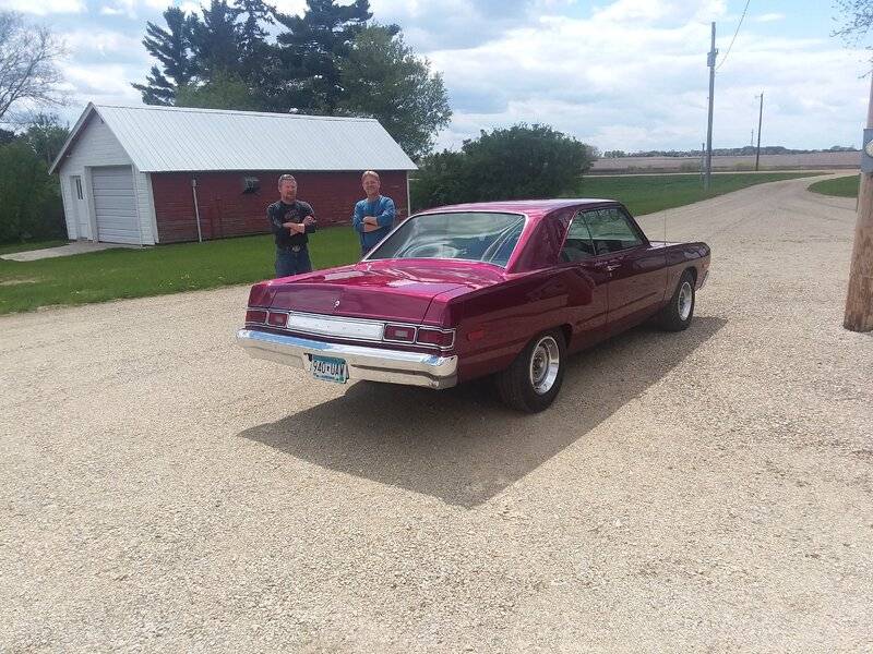

Lift brackets here on this '74 Swinger with stock rear shocks.
15" custom made rear rally wheels on this one too, 15 x 7 SBP.

got a picture of how they install?
im having a heard time visualizing it
You unbolt the Stock shackle turn it 90°, bolt the lift bracket to it through the 2 holes, then bolt the horizontal part if the lift bracket back into the factory holes, Think I did a little redrilling there to make it stronger where it bolts up to the sub frame, 2 bolt mount there too. Can put a reinforcement plate up inside the box section of the sub frame for more strength too.

PICS OF THE INSTALLED PIECES , I STILL DONT GET IT !!
