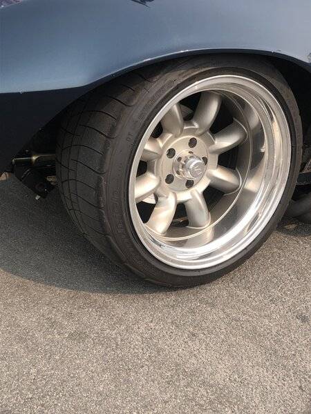

Although I love the larger diameter wheels, the tire has to have some sidewall so the 20" wheel look doesn't appeal to me in most cases.
At the same time, I also dig the "Day Two" period correct slotted wheels, the American Racing or Torque Thrust spoked wheels. One I really like is this style, made popular by Panasport:
I really like those Panasports. Reminiscent of mini-lites.

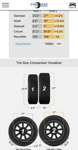

I think it blends pretty well, only thing i would maybe do is go with a 255/50R17 in the rear, the 255/50R17 is only roughly 1/4” bigger all the way around but will give you another 1” of tread width. The little bit of added height in the rear will also even out how the wheel well is filled, it may be the picture but it looks like the front tire is up in the wheel well a tad more than the rear. Going to the 255/50R17 would even it up while keeping the same stance. It looks good as is. Just a option.
Current setup.
Number 1 (Front Size) 225/50R17
Number 2 (Rear Size) 225/55R17
Wider back tire option.
Number 1 (Front Tire) 225/50R17
Number2 (Rear Tire) 255/50R17
