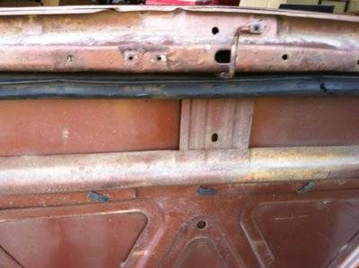

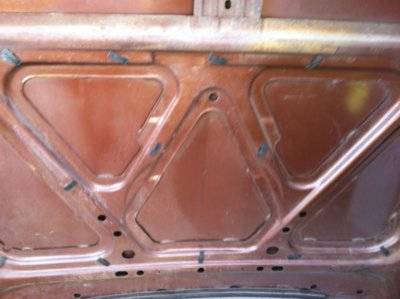

The later Dart hoods have a crush zone in them that enables the front of the hood to fold under rather than being pushed straight back in the event of an accident. An original Barracuda hood doesn’t have the crush zone. Please take a picture of the bottom front corner of the hood, (an area about 12” square) and post it so we can verify which hood it is.
Okay didn't know that but it will have to wait until the spring. The car is locked up and in storage. I don't have a garage anymore.
*EDIT*

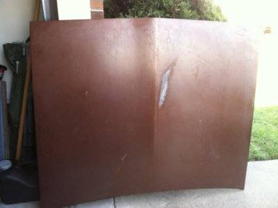

From what I can remember there are no reinforced areas on the front of the hood.
Dart Sport hood that I purchased 12 years ago in Superstition, Az.
Sorry for the delay. I have the car out of storage so needed to revisit this thread. The mystery remains on the cutout. My neighbours looked at it and said it looks like a factory cutout. This is a stock hood otherwise (no crush zone) for a 69 Barracuda. Also, my 70's original sixpack will not clear the hood without that cutout. It has stock motor mounts for the 340.
:wtf:
That hood scoop wasn't used until 1972, so, it can't be a factory cut out.
A really well done job, absolutely. But not factory. Heck, it's a nicer job than what the factory did. The factory just punched a couple of 4" holes, like this
