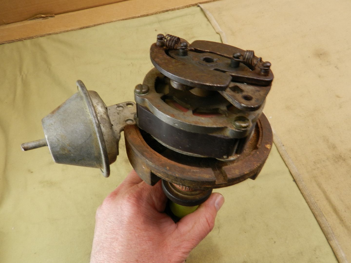

I did many years ago. Took one of the old Corvette breakerless distributors with a tach drive and shortened it, had a machinist tang the shaft end and redo the shortened casting for a bushing. It sat into the bottom of a collar cut off the bottom of a junk Mopar dist machined to fit the GM distributor.
This was a Chev dist redone for a SB Mopar, as they both rotate CW
This was in the early seventies, and was used to trigger a Mopar ECU. This was before I knew about rotor phasing and it did not run well. I'm sure if I'd played with it some I'd have found the trouble. This was also before some of us realized you could adapt the HEI module.
Like one of these
DSCN2182.jpg~original
Like one of these
