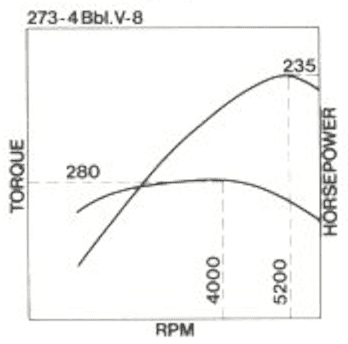

The Commando even with the factory cam was a revver. Not a lot of grunt down low (torque peak at 4K!), but it loves to wind. Look at this chart from the factory brochure.
Don't be afraid to see how it likes it at 6K -- it's overbuilt as hell for the displacement.

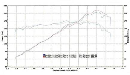

In this day and age it's easy to figure out shift points 'n such. There are several vehicle "performance gauges" I have a used G-tech for example. Anything that measures torqu or acceleration will do ya. You generate a curve for RPM in a known gear, and then plot that curve corrected for the other gear ratios. "Where they cross" is where you shift
Similar to this.......One axis is (here thrust) can be torque, acceleration or HP, the other axis speed or RPM.
That graph in post #4 is incorrect. Torque and HP always cross at 5250 RPM.

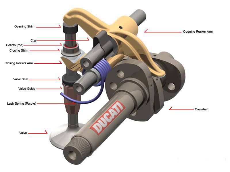

The only valves that cannot float to my limited knowledge is the Ducati motorcycles with their desmodromic valve actuation.
For a drag race, that graph in post #6 tells you to shift just past the hp peak ~5500 - 5700 rpm and operate around peak hp.
It does no good to go too far past peak hp @5200 before shifting. You lose hp and risk hurting the engine. For top speed in 4th, the Commando engine goes easily to 6000 rpm.
