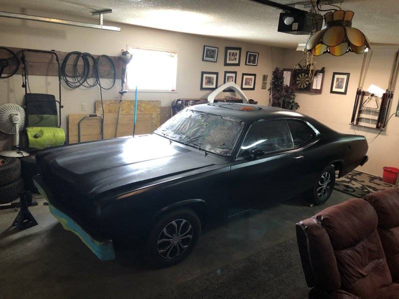

Happy to say that is not the case! This car has moved on. It is black now and still has a 340 between the fenders, but it is still alive!
Moved on as in you sold it, or as in you made progress on it? Just making sure I mark the tally correctly.
Glad to see it is still alive! Looks great. I love that it is parked in a living room. :lol:
