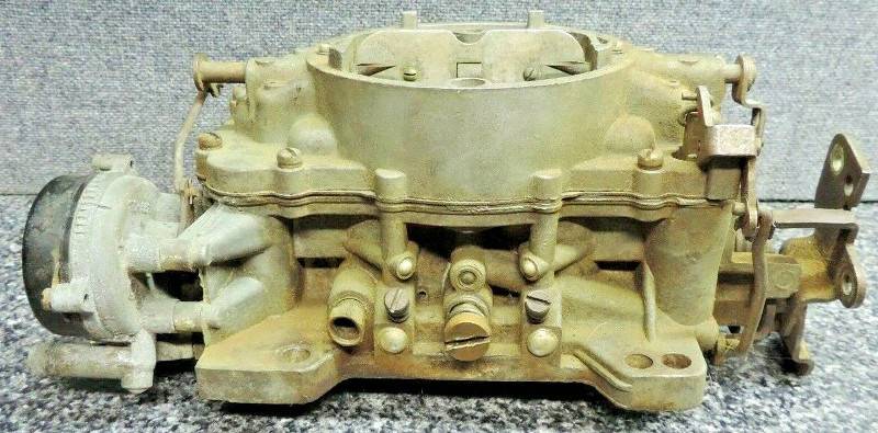

Bear in mind that some old carbs actually adjusted idle speed with an air leak. The old AFBs some models (I don't think Mopar?) had a great big screw in the middle between the two idle mixture screws. This set idle speed. EFI works the same way. The IAC (Idle Air Control) sets idle by leaking more or less air into the intake. The EFI corrects the mixture and ...........it........idles
Here's one now.........GM application Notice there IS NO mechanical idle speed screw on the throttle lever
MoPar has a similar carb with the third screw up top in the center. It was an air bleed IIRC.

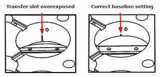

I knew what the Transfer Slot is but how does the word 'sync' apply ?
Isn't the transfer slot part of the 'off idle' circuit and feed air from the 'air bleeds' ?
I also know with a '4 speed cam' you don't need to drill the primary butterfly... but .. when do you need to drill that 'bleed hole'?
Can only assume it is needed with long duration 'full race' cams.

AFAIK 'sync' is AJ's term.
Yes the transfer slot provides most of the fuel in 'off-idle' but also low speed cruise.
As far as being a part of the 'off-idle' circuit yes and no; it's an intergral part of the idle circuit. It shares the fuel in ht eidle down well with the idle port.
Drilling butterflies is what was done when the throttle position at idle is too far open. Drilling allows the throttles to be closed further with the same amount of air as if htey were further open. Holley even supplied some carbs from the factory with holes in throttle plates.
On an old school Holley 4150/60, greater than .040" of transfer slot exposure at slow idle would generally cause problems as the throttle was opened.
The sidebar Urich and Fisher's Holley Carburetors and Manifolds covers proper throttle to transition slot relationship. (pp. 121-2 in the 1987 edition [Holley Part No. 36-73, HP Books])
The section is called Special Procedures for Wild Camshafts

Carter idle system is a little different than the typical Holley in that it uses a second air bleed and restrictor. So general rules of thumb for a Holley about 'square' or 20-40 thous. slot exposure don't apply. However the concept is still valid: More t-slot will provide richer idle. Too much or too little will cause flat spot or delay.
