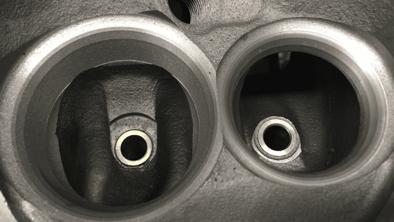

So if you used these, would you also completely remove the guide boss in the port?
I don’t when I install them.
The port side wouldn’t be any different than if you installed a straight .502 replacement guide.
Just looks like this:
