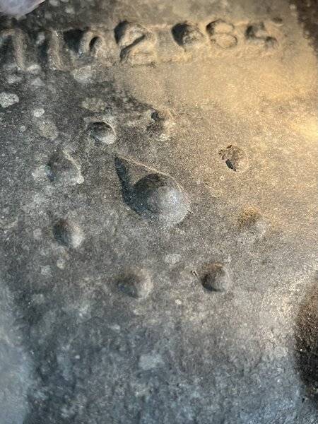

Reviving an old thread…
My -65 was shipped january 20th 1965. Casting date on my engine is 11 2 64, cast at 11 during the day shift. Due to the hollidays I guess this is as close as a «matching number» I can get.
However, with a new shifter console, new alternator and Edelbrock intake and carb, I guess he would never be considered as a collectors item for any other than me.
