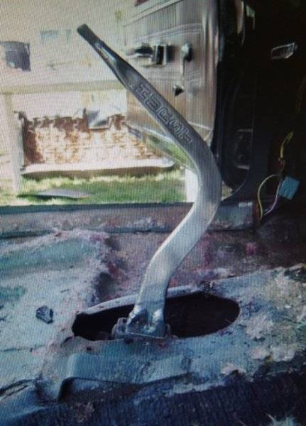

I had a bolt in handle, but sold it last year. Now wishing that I never did.
Here is a picture of it.....
I have all 3 but stilll does not help on what the shorter on fits. I personally thinks it’s for January of 68 a bodies.
Where is it shorter? Before the bend or after? That is, I'm assuming the the angle of the bend is the same as the other handles.
I'm looking for a bolt in one that matches my current bench slip in, I believe the bolt in one pictured above is a close match but I cannot find actual measurements. I did more research on numbers but it's not with me at the moment.
The one on the top is the 5973, hard to see in the picture but is a little shorter. Also angles down
I see that there is quite a difference between them.
Was the 5973 handle listed for a A-body?
Also those who have talked about the existence of a bench seat handle have said that the
handle is angled forward more in order to clear the seat.
If your sure its an A body shifter, that lower angle would have to be a bucket seat car. IMO.
That looks like the "A" Body Aftermarket Competition Plus shifter with the welded handle. I have a couple of them. What are you looking for?
I'm looking for the chrome stick.
I know now it is not a push in or a bolt on. The stick actually goes into the shifter case.
I want to take the handle and cut it off at the welds, drill holes, and bolt it to my current shifter.
I want to be able to cut it so it is the correct height when installed as I have a bench seat.
I had attached a pic in the link below of the handle going into the mechanism but it was removed and I deleted from my phone
