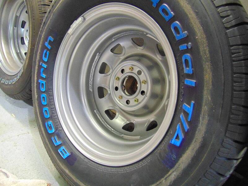

By using various supplier's kits to move the springs in 3/4 of an inch on both sides (yes there is a big squall about how far this moves the springs). I found that I could get 7 inch wide rallyes on the car with 245 60- 14 tires. With the Dart Wheel wells you can't go out much if at all. But you can get them to make the wheels with custom offsets so you can get the extra 1 1/2 inches (compared to factory 5 1/2 wide wheels), all on the inside and retain the factory look on the face that shows. I think all the new rallyes that are being made start at 6 inches wide as opposed to 5 1/2. and they are made with the extra 1/2 inch on the inside. If you go that way, the factory trim rings fit like they should without a big gap between the ring and the wheel. By using 205-70 14s on the front you get very close to the same side wall height front and back with more tread width on the back and from the side of the car they look the same front and back. I just put together a new set for my current project and here are some pictures for your consideration.

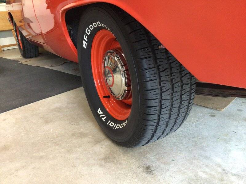

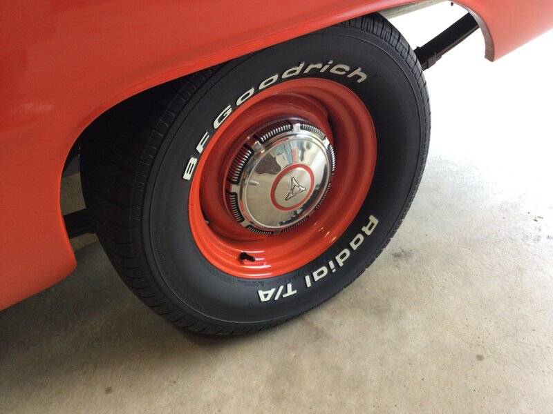

I wanted to put body colored steel wheels with red line dog dish caps, but the SSBC disc brakes up front "put the brakes" on that idea (pun intended). So, I kept the 14 X 5 1/2 Rallyes up front (P195-75R14) and found a pair of WheelVintiques 15 X 7 (from Ken member 72Dart6pack) for the rear (P245-60R15).

Very nice! Are these wheel vintiques? I was test fitting some wheels I bought from them and it seems like they dont fit well over the KH front hubs? any issues with yours?
Yes - I found 2 things:
1)these Wheel Vintiques rallyes are more precisely made as "hub centric" wheels than original Rallye wheels, which I think is good, but if you have corrosion or paint built up on the hub, it will interfere with the fit. I ended up using some medium grit sand paper and then some steel wool to really make the hubs clean.
2) Vintiques makes the wheels for a tight fit and then they powder coat the wheels (which makes for a great durable finish) and they do not seem to take thickness and durability of the coating into account when they engineer the wheels, so I ended up sanding the inside surface of the hole for the hub to remove the powder coat.
In both cases I put a thin coat of bearing grease on the bare surfaces to keep them from rusting and now they seem to come on and off with ease. This was not the case with earlier sets of these wheels (mid 1990s and 2005) that I got from them in the past but they were, I believe, just painted.

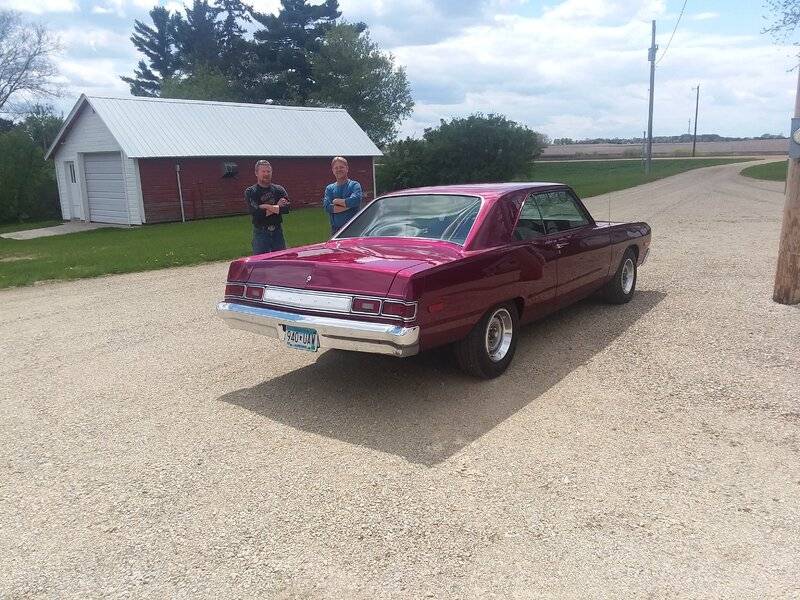

15x7 (4.5 back space) and 255-60's on the rear. 14x6 and 205-70's on the front.
They are close on the rear but no rub. (closer on one side)
