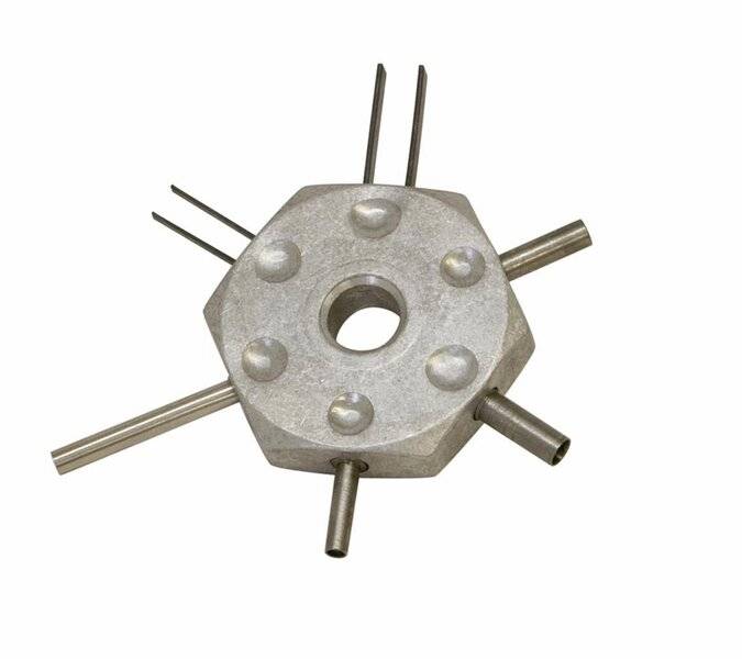

I’m looking for the small tool or tools that release the terminals from ignition switch and turn signal switch. See the picture. Anyone know where I can find or buy them? Thanks
^^^ Lisle 56500, eg. Carquest or other better automotive stores.^^^
Anyone know if that will work on a modern FCA fuse block?
Got the Lisle 56500 in today and it works good on the smaller wires but doesn’t go big enough for the larger terminals like on the ignition switch connector. Do they make another tool that picks up where this one stops?
I used this tool but unfortunately I don't remember where I got it or what brand it is. I do know I purchased the factory connectors from Radio Shack when I rewired my Duster. Maybe someone can identify it.
