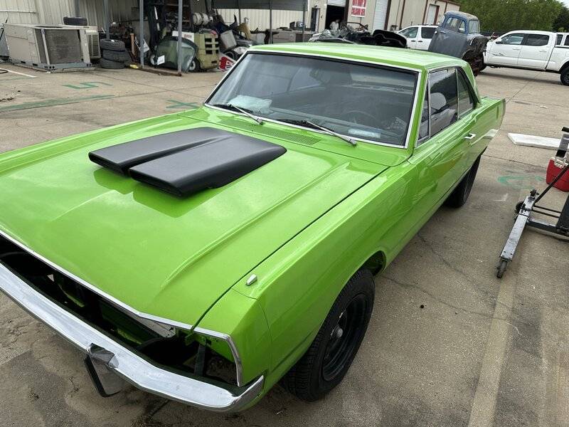

I am having the two 4 inch holes cut into the hood under my dual snorkel to help cut down on some heat under the hood.
I need to get this to my body shop asap,
Thanks in advance..
I was thinking of cutting the whole diamond area out and using some seam sealer to seal the supports to the hood skin..
or using a 6" hole saw instead of the 4 " and cutting the two cutouts..
Rather than hole saws see if a local electrician has punches the size you want.
They will make a super clean hole
Does this scoop use the same grommets/seals as the dual scoop hoods?
If so, I would suggest trying some different sized diameter hole saws or punches on some scrap material to find the perfect diameter for your grommets/seals.
I used a hole saw. Then light file and sand paper. But have the rubber
