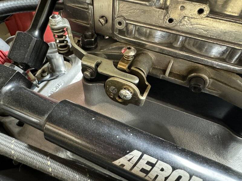

Idle Transfer Slot on secondaries?
I don’t see any restrictors in the main body do you?
No Sir, not sure if any carbs actually come with them, think they just drill them to a predetermined size.
If I were you, I would just start with squaring the primary Tslot and close the secondary until your idle lowers. After you get there see where you’re at.
I think you’re idle is too high right now. Listening to your engine I have a rougher cam, 251/258 at 50, and I can bring my idle down to 750 if I want. I use 900 to keep the cam lubed at idle.
Ok the link with explanation is good and I understand it. This modification moves the IFR to below the fuel line making idle smoother for a lower vacuum system because it is submerged and less affected by air pressure?
I see this modification can be done on both carbs as a typical modification by many people. Saw a video on this as well.
I assume if I mess it up I can get a replacement metering block worst car right? Are all 4150 metering blocks the same? Do they sell metering blocks with the lower T-Slot restrictor set up?
Also what is the reason to use the Holley base plate on the Proform? Is it because of the linkages?

Bewy, I hear and have seen how A significant Advance like 43° at idle can smooth out the idle. But if the mixture is off due to lack of airflow because of the throttle plate exposing to much of the T-Slot then it seems to me (not claiming to be an expert here) the added advance to compensate is not the right approach. It masks the fundamental problem of a bad mix.
Seems like tuning is an iterative process going back and forth from carb adjustments to timing tweaks.
I did buy the Progression Distributor so I will easily be able to modify the curve at will and on the fly. But I need to have a tuned carb that isn’t way off like I feel it is right now.
Does this make sense? I am trying to learn here and this thread has been excellent for me.
