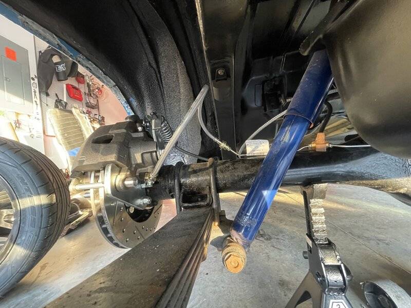

I have a 1971 Demon and did a 4 wheel disc power conversion setup from right stuff. They said everything was just bolt up which was partially bullshit. There is so many problems im ready to sell the car at this point with the amount of money i have invested. Disc kitswent on and bolted up no problem, but after that is where all the problems start. The power booster they sell comes with the wrong size petal bolt. Had to order a correct one. Next the brake line kit is a ******* mess. They have no diagram, instructions, or know how it is to be setup. I contact tech support they tell me there isnt any diagram. Ok so you sell a customized setup for conversion and no god damn instructions!? So i have them read where each bar code is labeled the best i get is rear or front. So i spend all day trying to figure out how the line are supposed to go and to me loose flexible lines not supported with a bracket seems sketchy. The front flexible lines dont go through the support brackets they are too big. Driver side hard line doesnt fit. And worsttttt of alllllll. The master cylinder lines they tell me that go to the original manual brakes distribution block have no scenario where they even come close. Every scenario has them pointing to the front, towards the hood or to the firewall. This is a complete mess i am at the point where im going to just undo everything to stock and loose thousands of dollars or sell it. How are people running rear disc kits did people not convert there lines and are using smaller drum brake lines? I dont get it because this setup pictured below seems sloppy.

Trying my best need pics of brake line setups and intermediate line photos, this is an example how am I supposed to secure flexible hose eithkut a braket that wanst in kit
Being more race oriented I would use a stainless zip tie or two. That or summit and speedway sell brackets.

So somebody posted a picture of the line set, and now it has disappeared. If the picture is still around here is a description of where they all go:
Long line through the middle and up to the right goes from separate proportioning valve to the rear axle
two small lines right bottom are from the distribution block to the master cylinder
line with half moon at the bottom on the left goes from the "T" on the rear axle to the passenger caliper
Top line on left goes from distribution block across the firewall to the passenger front caliper
small line in the middle on the left goes from the distribution block to the driver front caliper
and the small straight line in the upper middle left (only one left now) goes from the distribution block to the proportioning valve
I wish I knew how to draw on the picture and I could have numbered the lines
I'm not convinced that the master cylinder lines are wrong - the long run just out of the master fitting is to run the lines back toward the firewall (because of the power booster and bracket) then the loop and down to the distribution block. are the lines that you bought original mild steel or stainless?
