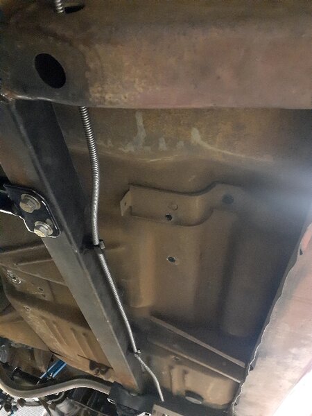

In the first pic, the coil around the line is almost always for a location that requires that portion of the line to run very close to another part it could rub on, or be pinched between, such as between the inner fender and the frame horn.

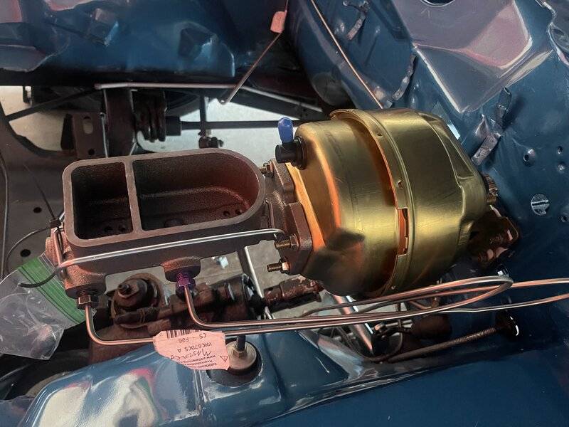

****update i got the top lines bent to work for the distribution block to master cylinder now im scratching my head because someone said my master cylinder is disc drum, i called right stuff they said the master cylinders are the same for disc from or disc/disc kits the only difference is it comes with a rear proportioning valve when you order disc disc which is what i have but the reservoirs inside are bot equal nut offset is this accurate and ok? They told me all lines go to the original drum proportioning valve which they are all connected now, then the disc proportioning valve goes in the rear in between the intermediate feed and rear feed.
The difference in MC is a "residual valve" not a prop valve.
The residual valve also does not necessarily have to be in the MC, it could be in the distribution block.
There are two master cylinder power kits the master cylinder bore set i have is 1-1/16” bore or the other is 15/16” bore. I have large bore and rod version dont see why that doesnt work someone said i have a drum master cylinder so not sure ehat to believe is going on here
I suspect that comment was made because of the 2 different sized reservoirs on your master. Disk brakes use more fluid as it fills the caliper piston cavity as the pads wear down (master level drops). That's why that reservoir is larger. When guys add rear disks from a doner vehicle (Jeep for example) they typically use the same master, but remove the residual valve from the port of the master that feeds the rear brakes. If that is left in, I believe that the new rear calipers either don't release, or release slowly. A new proportioning valve (maybe adjustable) is added to balance out the braking percentages between the front and rear because of the new disks.
I would expect that the master that you received in your kit contains no residual valve for the rear brakes, so you should be good there. Just keep an eye on the fluid level in the small chamber over time as the brakes wear.

I agree. I bought all the components, and a good friend and I plumbed the whole car. The hardest part, was getting the coiled tubing straight enough for my anal brain. Strange put the axle vent on the right side tube, so I had to move everything over to that side. The plumbing from the master goes into the interior for the prop-valve and Line-lock. I also always run the front cross-over line in the interior.

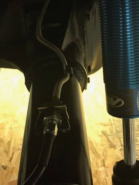

The picture in #40 shows the stand off on the axle housing for the line/flex hose junction. You have to shorten the stock line. If a flange is on the bottom of that stand off, you can use a large hose clamp to attach it to the axle housing, no welding. Did mine that way. Sounds like the other end of the car is for the starship Enterprise. Sorry no pictures, car is in winter storage. I agree, you don't need power brakes. If Right Stuff can't resolve their problem, see if they will let you return it and go to Dr Diff. You are probably a little deeper into it than that. You still will have some work to to do.

I contacted Doctor Diff, I ordered their 4 wheel disc aluminum master cylinder with 1-1/32” bore size per their recommendation for use with power booster. They said the proportioning valve in 4 wheel disc brake is recommended as a fail safe just in case more pressure happens for some reason during rapid braking. So i will be adding the adjustable to the rear line coming off the master cylinder connecting to rear feed line. Thank you everyone for you input as always.

I'm not sure what you're saying...but I don't attach stuff to my car with hose clamps.....or duct-tape. There are no rubber lines on the car.
I am saying that the stand that your hard brake line junctions with the flexible line from the caliper. That stand can be attached to the housing with a large hose clamp if it has a flange on it. Been on my car for 2 years, just as tight as the day I installed it. That stand would not have to be welded on, it's an option. A hot rod shop suggested it to me. In the past, racing, have had a lot of duct tape on a race car too.
