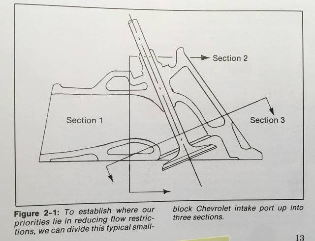

Are bigger intake valve's better for low lift flow? 3 angel, or 5 angel valve job? Just asking, trying to learn
My guess he's talking .200-.400" lift
Valve area is the most restrictive then next is bowl then port opening.
A bigger intake valve will increase low lift flows, with minimal porting peak flow will occur at a lower lift.
Five angle valve job and back cutting the valve will smooth out low lift flow.
Shoot, actually y'all are pretty educational ! I was wondering if Dan, the OP, was thinking about using a low lift, non-radical cam, to improve performance ( if he ever found " The Car"
The valve is the restriction up to .25 L/D ratio. After that, it’s the throat size that takes over.
Sorry buddy, what is the L/D abbreviation?
Lift vs Diameter?

First define your idea of "low lift"
The way I always read it, up to .400 most of the time. Other writers have listed .450. My best guess is it is dependent on what Rat B was saying. I’d go with that myself since changing parameters of valve size and what’s behind it modified or not and when it takes over (the bowl area) are or become a point of perspective or actuality.
Good question Dan! I e read up from several sources and this is what I have learned. The answer can be a simple yes BUT it is not always that simple. Let’s start with the valve itself.
A 1.88 vs a 2.02. The larger valve will flow better everywhere.
Why?
The diameter of the valve has more area in which the air and fuel can pass on by into the cylinder. But……
That’s just the valve itself. Let’s just assume the valve job is done at the best advantageous angles and the valve is set in its seat at the perfect placement height. If the bowl area under the valve is t sized and/or ported to it’s best size, the valve will not flow it’s best.
When you take out a 1.88 valve and install a 2.02 without any work under the valve, the gain is very small, just a slight improvement at best. The gained curtain area isn’t maximized. It’s kind of a waste of a mod at this point. Also it’s why a factory 2.02 head is a more or a prize head over a 1.88 head or the same casting.
