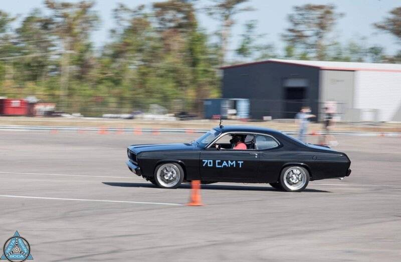

I've never not run offset spring hangers, so I can't compare it to a stock setup. I'd be willing to be there is no difference. Now, the 3" offset kit for a handling application may not be the best idea.
