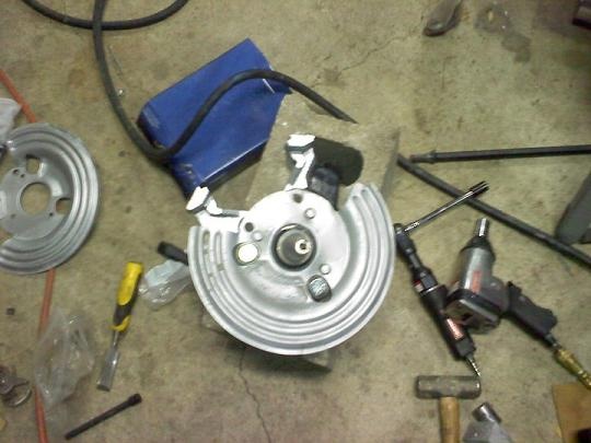

well im back at it. im putting the spindles together. I either marked one of the caliper bracket/adapter wrong when I took it apart last summer or the whole thing is backwards.
Here is some photos does this look correct this is the passanger side?

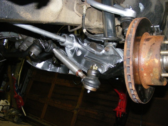

Here you go Bill. Im installing the LCA into the K frame Im wondering if there is suppose to be a gap there or do they need to touch?
and if all is correct I should be able to tighten up the ball joints and pin them right?
