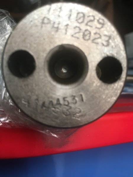

Somewhere here at the forum somebody had a list that I can not find on MP cam numbers. Below is a MP cam that lacks the last digit that could possibly decide if it is a 292/509 or a 284/.484. *I Think!*
But as we know, sometimes things get funny with MoPar numbering system.
Any positive cam ID help or cam listing would be highly appreciated.
All you have to do is mic the lobe
Its ether a 1 or a 3 as you know
@brian6pac Thanks. I got in touch with the last owner of the engine and it is a 292/.509z
Thanks bud!
