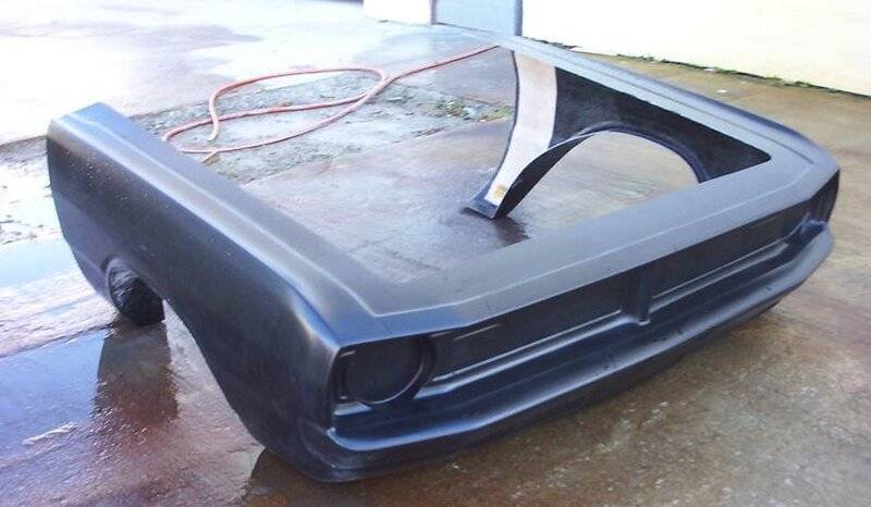

The best way to eliminate engine compartment drag is a one piece front.
I will be using one now on the new build
I'm holding off chopping them and will try some more weight loss. I could stand to lose 22 pounds myself !
You'll get that 22 pounds off pulling your vent window frame and glass, that a surprisingly heavy piece.
No 1 piece front ends available that I've found for pre 67 A bodies.

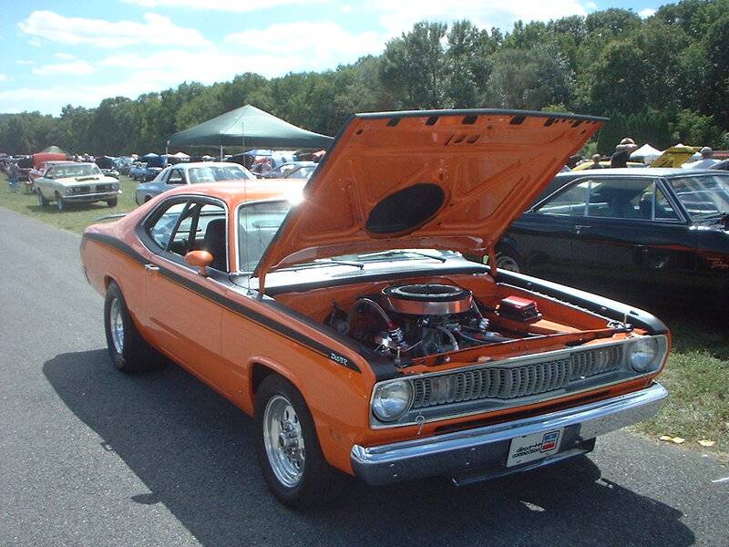

For what it's worth my car has the inners removed completely. Of course it's reinforced at the shock towers with strut bars like should be regardless if they serve as weight bearing or just shock mounts. My car seems to mph better than it should given the combo so, I doubt there's an increase in aero drag.
Look at that avatar !
Dude....way to go, really impressive.
