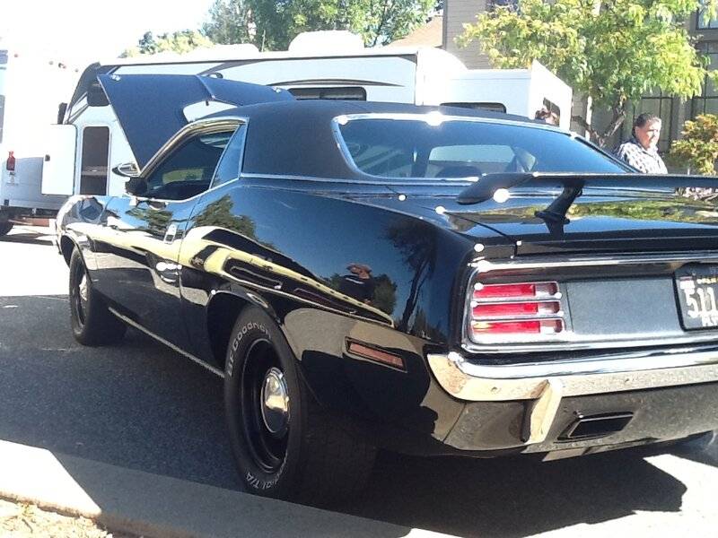

I just ordered another pair of race cats for my 493" RB based motor in an attempt to repeat this effect. I'm hoping there is no noticeable performance loss on this engine either.
This style racing converter is pretty short at 6" in length with a 3 1/2" inlet and exhaust and a 4 1/2" wide body. I may have to use a tapered reducer for the exhaust side conection, but the inlet side will fit on my reducer, as it is 3 1/2" already. This car has a full 3" TTI exhaust with 2" headers and electric cutouts with ovalized megaphone tips to sweeten the sound.
I'll update the results when I get back from Carlisle and install them. This car is also getting a multi point EFI conversion in another month or two. Both upgrades are an effort to make the car much easier to drive and enjoy more often.
