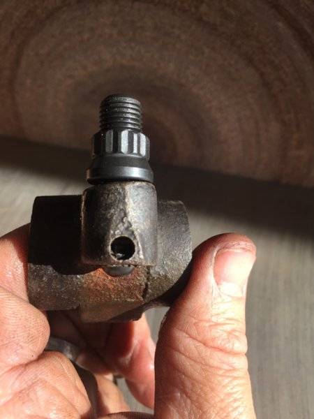

Hoping someone chimes in with experience on how they did this. I know they should not screw in and out easily but. Mancini Racing said I need to go through my rockers with a fine tap. Is this what you did to get them in? I have already broken one allen wrench trying to install the first one I tried. Any help would be greatly appreciated.

This is why you will also need to face the rockers:
Pic stolen from this thread, which is a handy read:
