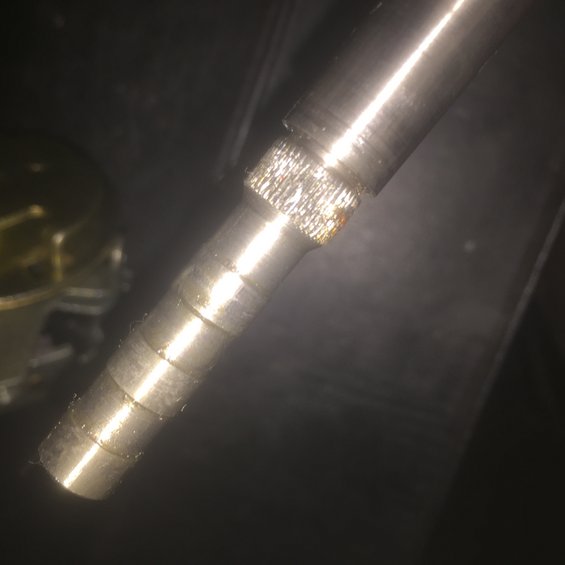

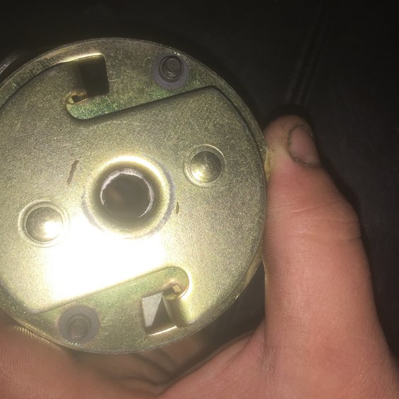

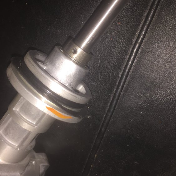

Hey guys, im a pretty acvtive preventative maintenance nut. Change fuel filters every year along with oil. Change plugs every two years. Well its been about four years since the cars been done and decided to replac the distributor cap and rotor. So got them in mail today, swapped cap over no issues there. Noticed that the rotor is a little snug on the distributor shaft. Pulled it off and put new one on. Put everything back together and no start, wtf. I knew firing order was correct because I swapped them over one by one. So i noticed that the rotor spun with a pretty good amount of play, then also noticed that it was spinning freely which i know it shouldnt. Crap. Pulled distributor and noticed the distributor shaft knurls had come loose from the upper part of the distributor. When i pulled the rotor off I remember the upper mechanism moving quite a bit. Upon further inspection looks like the advance mechanism pulled out of the distributor base. But why would it? Isnt it supposed to be fastened to the distributor base? Mine looked more like just line up pins to me. Any thoughts

Heres the bottom of the pickup and advance mechanism. In the center is where it fits down on the knurls
Heres the knurls on the top ofbthe shaft
How it fits together in the distributor housing
Bottom of shaft
Where it goes against the housing
I'm not familiar with how that dist. is constructed. It looks like it has come loose where the shaft goes through the pick up plate?
Thats what im thinking? The shaft goes in from the bottom as shown in last picture. The pick up and advance mechanism on top pic sets down in distributor housing onto the knurls, the knurls are what holds the pick up and advance to the distributor shaft. The knurls hold the the shaft with the pick up and allows the shaft to transmit the rotation from the distributor gear to the rotor, pick up and advance
That appears to be a cheap knockoff of the MP distributor made by Mallory. It's not a factory Chrysler distributor. It's come loose from the main shaft. I have no clue how you would go about getting it back in the right location. I would throw that thing in the ditch and get something better.
I was thinking the same thing,how would you know how to put it back together in the correct phase?
